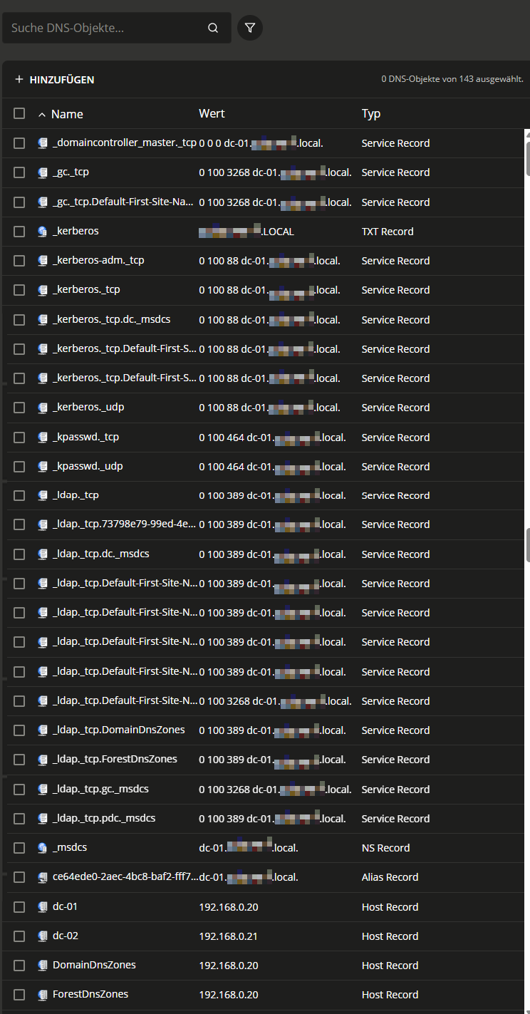

Here are the DNS records:

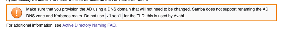

Yep… i was going to show this taken from the SAMBA setup docs:
i’m not saying this is the cause of this issue, but the once a setup deviates from the norm, the harder it is to debug.
also if you expand the system and add other subnets, i’m not sure that local will function outside of the subnet that the server is in.
but i do remember the first time i setup univention i had a hell of a time with exactly this sort of name resolution, even using a full .com, and in one case it was related to the windows AD server doing some things over ipV6 to “.local” & “.localhost”
