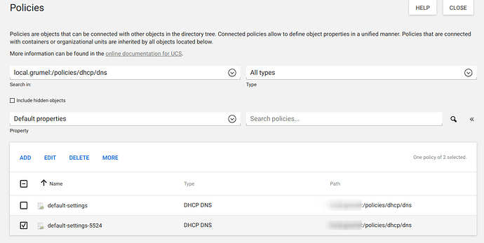

I created the second policy. They are looking like this:
First:
Second:
Summary:

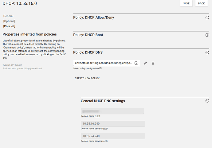

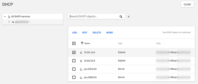

Then on the DHCP side, I have linked the policies to the subnet like so:
First (ok with 10.55.16.240 as first one):

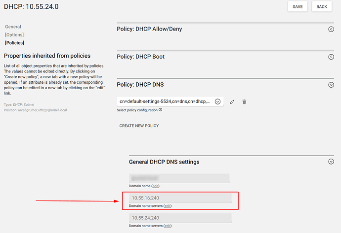

Second (the first one should be 10.55.24.240):

Then on the windows machine on subnet 10.55.24.0/24 I get this:
And also in Xubuntu I get the same results:
So how I can swap those 2 DNS entries around? I mean they are just fine for the 10.55.16.0/24 subnet, but not for the 10.55.24.0/24 subnet.

Looking at your screenshots show that you entered the servers in the same order in both policies. So in order to fix this:
  1. Edit your second policy,
  2. Remove the entry for the .16. subnet & save,
  3. Edit the same policy again,
  4. Add the entry for the .16. subnet as the second one & save.
The additional step is required as simply swapping both entries doesn’t seem to work — probably because the UMC thinks that nothing has actually changed and therefore it doesn’t have to modify the entry.
