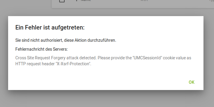

Edit: Additionally, I am getting this error message on UMC after idling for a while:
Bildschirmfoto%20vom%202019-02-23%2017-39-29
